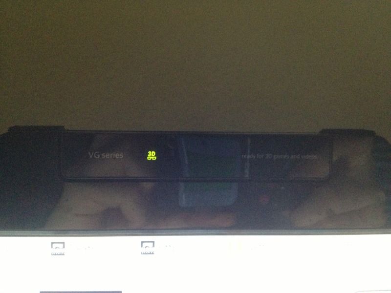

VG278H and GTX470 and this is definitely not working… no difference in blur. few things I’ve noticed that are kinda weird
-I don’t have the strobe on/off options from the tray icon:
http://i17.photobucket.com/albums/b78/dufric88/Untitled_zps4a62d5ba.png
-My 3D panel light is stuck on (which may be a side-effect of having lightboost enabled, but I’m not noticing the intended effect):
http://i17.photobucket.com/albums/b78/dufric88/0B94D56D-F276-4EB6-9D55-D58AC44FD671-3045-00000302BCBCDDF1_zpsacb87905.jpg
-Looks like the ability to toggle stereoscopic 3D was completely removed from my control panel:
http://i17.photobucket.com/albums/b78/dufric88/Untitled_zps54b1fdbf.png
-The UFO motion-blur test links to a password protected site
