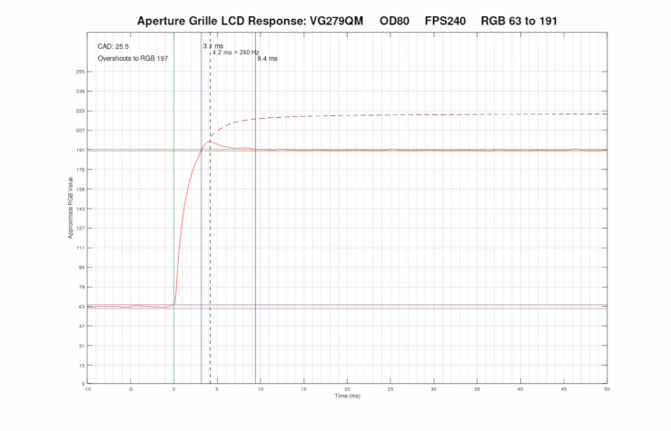

By increasing Overdrive Gain (pixel voltage) correctly we can boost GtG response and mitigate ghosting during motion, or in strobing case mitigate some of the double images. As many already know, too much overdrive can overshoot/undershoot the target colors and result in inverse color ghosting/double images. Overboosted transitions also take longer to fully complete. For this reason it is recommended to use the most balanced option.

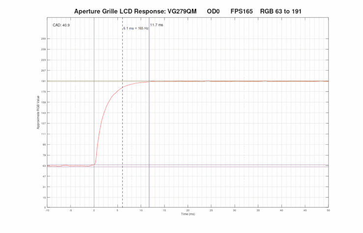

Overdrive on 4 presets is automatic and provides excellent gain selection for any refresh rate. Once Custom preset is selected it is up to user to find the most optimal gain. A general rule for non-variable or non-automatic overdrive is that larger gains (overdrive level or pixel voltage) exhibit more overshoot at low refresh rates due to voltage being fixed and not self-adaptive – Normally GtG momentum is interrupted by refresh time; Because lower refresh rates take longer to update, GtG curve will keep rising/overshooting or falling/undershooting until new refresh cycle interrupts the momentum. The longer the refresh time, the further the interruption and larger the overshoot with overdriven LCD.
This also means higher refresh rates can handle larger gains for faster GtG. However, due to mentioned reasons, a gain perfect for 240 Hz is most likely bad for 120 or 60 Hz and needs to be manually corrected. For those who switch between refresh/frame rates often, process of constant re-adjusting can be a bit tedious. This is the area where PureXP/utility could have been improved. Why does user need to find optimal overdrive for every refresh rate if the firmware already knows how to do it? An optional auto overdrive would’ve been nice.
Here is a chart showing optimal overdrive across the range.
