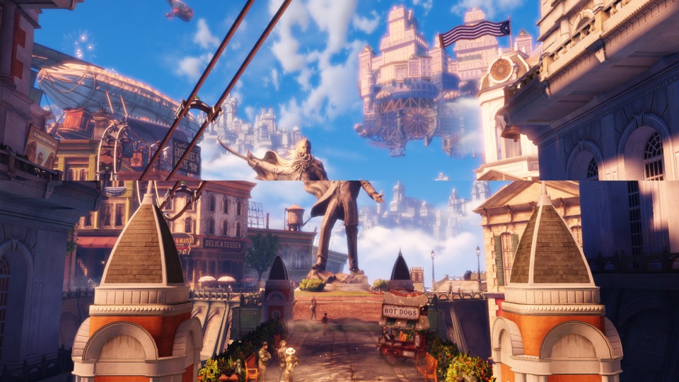

Positions of tear lines often fluctuate, as shown in the animation above. Tearing also becomes more visible during faster horizontal motion (e.g. turning, panning, strafing), especially at lower refresh rates. It shows up in many games, as parts of different frames:
This screenshot (Bioshock Infinite) shows tearing, where the statue in the middle is disjointed, as well as the rail and buildings to the side. During fast horizontal panning motion, disjoints show up randomly all over the screen, similiar to the above animation.
Trying to replace the frame during mid-scan, creates a tearline. The position of the tear depends on how far along the scanning is, as seen in the high speed videos earlier.

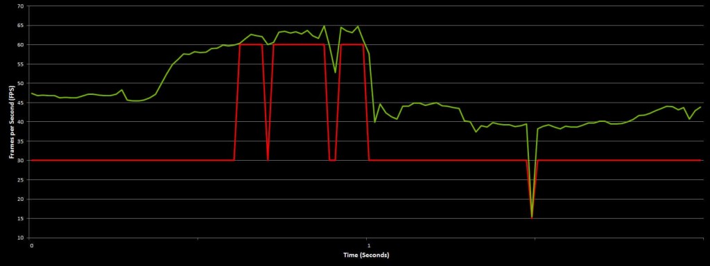

Sudden Frame Rate Slowdowns
During VSYNC ON operation, there can be sudden slow down in frame rates when the GPU has to work harder. This creates situations where the framerate suddenly halves, such as 60 frames per second slowing down to 30 frames per second:
During VSYNC ON, if your graphics card is not running flat-out, these frame rate transitions can be very jarring. These sudden changes to frame rates creates sudden changes in input lag, and this can throw off gameplay and aiming, especially as action gets heavy in a first-person shooter game. The red line (VSYNC ON) below illustrates this jarring effect relative to the green line (which represents VSYNC OFF and G-SYNC).
