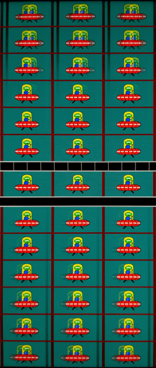

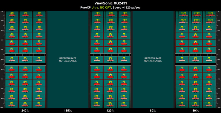

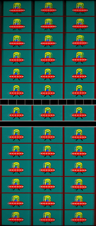

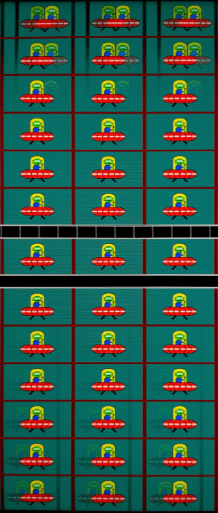

Crosstalk – Standard Vertical Totals
This is what XG2431 can achieve with standard vertical totals (out-of-the-box). To see improved crosstalk with large vertical totals (QFT), check the Large Vertical Total section.
