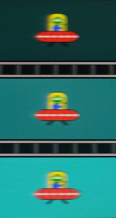

Ultra Fast looks good! At 240 Hz both initial and full response times are moderately sped up with zero overshoot errors. Since XG2431 does not use variable overdrive, overshoot will start to creep in as refresh/frame rate decreases (fixed or in VRR). It faintly appears at ~120 Hz/fps, from ~100 and down it becomes more noticeable. Decent range coverage! This overdrive is my recommendation for the specified range. There is still a bit more room left to push GtG at max Hz. To cover more range without inverse ghosting, ViewSonic had to compromise 240 Hz performance and pick a lower gain. Ultra Fast is most optimal for ~150 Hz/fps. Larger gain would allow better performance at 240 Hz, but unfortunately there are no faster options available in OSD. For this reason requirements of users who game at around 240 Hz/fps may not be fully met!
For VRR XG2431 uses Low Framerate Compensation (LFC). With LFC as soon as frame rate dips below the minimum VRR range value (48 fps) the display driver starts doubling the panel refresh rate to stay within VRR range and synchronized. Higher rate means faster refresh times, so one trick that can help tame the overshoot at lower frame rates is to change the VRR range from default 48-240 to something like 110-240 fps. With this mod overshoot gets cut in half (LFC multiplier dependant) for frame rates below 110. VRR/LFC range can be edited in Custom Resolution Utility (CRU). It’s worth noting that LFC toggling on/off can feel a bit stuttery when frame rate fluctuates just around the threshold. In that case change the value to something more appropriate.

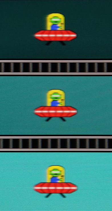

At expense of slower GtG, Advanced manages to cover full range with basically no overshoot. It performs best at ~90 and 240 Hz is less decent. Overshoot at 60 can be spotted in specific tests, but it is very faint and not noticeable in practice. It’s fine even at 48 Hz. This is a set-and-forget option for those who utilize full or lower-end range on a daily basis.
Standard is OFF setting. At high refresh rates the difference between Standard and Advanced is very tiny, while at lower end its more spotable. The very faint overshoot of Advanced at 60 Hz/fps is gone, but ghost trail is slightly more pronounced. OFF setting generally serves no purpose, but is usefull for checking panel’s native GtG performance. For some reason Standard is a factory default overdrive.

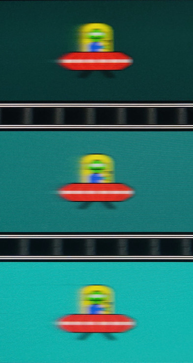

Interestingly Ultra Fast behaves differently when “User” Color Temperature is used. It appears to bug into a much larger OD gain. Unlike with other temperature settings, “User” excessively overshoots throughout the range. 240 Hz doesn’t look good, let alone 60. Standard and Advanced overdrive seem to not be affected by color temperature setting. This leaves users with less options if they decide to manually balance color. Thankfully “Native” Color Temp is fairly accurate according to other reviews so you won’t have to bother with manual adjustments. Native is also a factory default setting. Combining the two should be avoided for obvious reasons, but some users prefer a more responsive feeling of overboosted GtG so it may end up being weirdly useful. The bug might be due to firmware leftovers. Some other ViewSonic models had more levels (Standard, Fast, Faster, Ultra Fast, Fastest), of which last one was usually just as aggressive.
