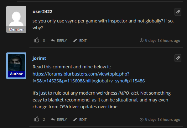

I would like to know how to set VSYNC correctly, I read in some forums that you do not directly recommend setting VSYNC from the nvidia control panel in a generic way. So how should it be set up? Thank you so much for what you do.
