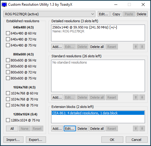

  1. Launch ToastyX CRU.exe
  2. Doubleclick the Extension block as indicated:
  3. Next, select the nearest refresh rate that matches your ULMB refresh rate:
  4. Put the radio button on “Pixel Clock” (this locks output in pixels per second)
  5. Put the radio button on “Total” (this locks Vertical Total)
  6. Now manually increase the number in “Vertical Total” until “Refresh rate” falls to “60 Hz”
    This automatically reduces refresh rate while leaving Pixel clock unchanged.
    Observe when you manually increase Vertical Total, the Refresh Rate automatically decreases.
    If Refresh Rate is still above “60.0”, increase Vertical Total
    If Refresh Rate is now below “60.0”, decrease Vertical Total
  7. Make progressively smaller changes to Vertical Total when calculated refresh rate becomes closer and closer to 60 Hertz. You will get very a number that is very close such as 59.95 Hz or 60.05 Hz. This is okay, you just have to get as close to 60 Hz as you easily can.
  8. Click the OK button.
  9. Run ToastyX restart64.exe (that came with ToastyX CRU) to restart your graphics driver.
    If you cant find this file, just reboot your computer instead.
  10. Test your 60 Hz refresh rate via Change Display Settings -> Display adaptor properties:
    IMPORTANT: If your monitor blacks out when you do this, this probably means your monitor does not support the custom modified resolution. Your monitor will automatically restore itself in 15 seconds. Then try checking Blur Busters Forums to get help.
