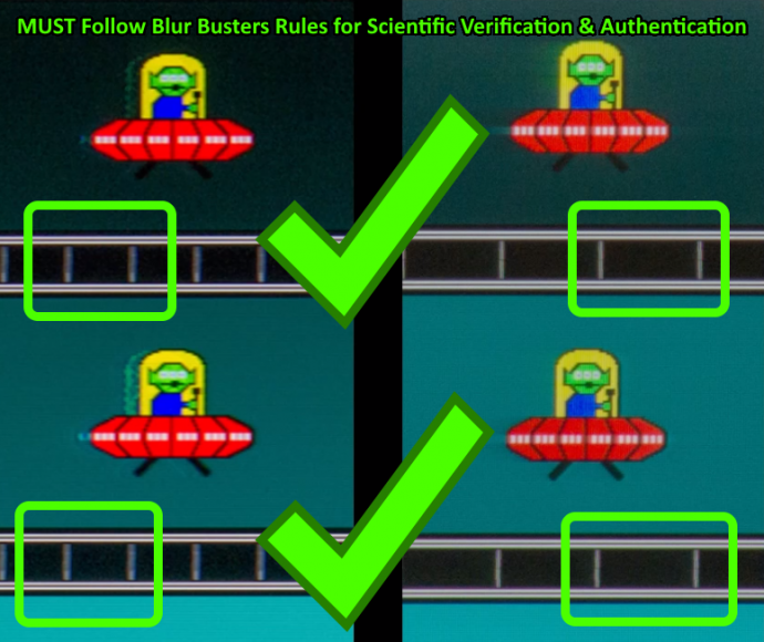

When done accurately, the Sync Track is successfully captured as follows:
Camera Tracking Accuracy: Verification of Vertical Accuracy
There must be a clear 1-pixel black gap inside the fine horizontal white lines.
This verifies your camera didn’t shake vertically (e.g. camera vibrations).
Camera Tracking Accuracy: Verification of Horizontal Accuracy

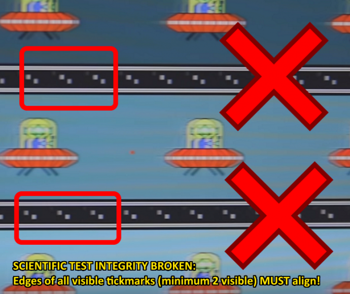

If your pursuit camera photograph is not successful, then it is easy to identify the flaws. As a general rule of thumb, motion flaws are visually identifiable as follows:
Artifacts That Invalidates Results (adds unwanted motion blur)
- Broken vertical lines: camera was not moving near correct speed
- Vertical lines slants backwards (\): camera moved too slow horizontally
- Vertical lines slants forward (/): camera moved too fast horizontally
- Wavy/curved vertical lines: camera moved horizontally at a varying speed
- Sync Tracks not consistent (left/right edges, or different sync tracks): camera was rotating/skewing/tilting while tracking.
Artifacts That Don’t Invalidate Results (results valid if vertical segments are aligned)
- Missing portions in lines: exposure was less than 4x refresh
- Segments of lines is brighter: exposure was greater than 4x refresh
- Thick vertical bars: lower refresh rates & sample-and-hold displays
- Thin vertical lines: higher refresh rates & strobe displays such as LightBoost
- Noisy vertical lines: temporal dithering (plasma, DLP, some LCD’s)

Verifying Tracking Errors
Pursuit camera photography on LightBoost displays
Broken vertical lines: camera was not moving near near correct speed

Excellent Pursuit Camera Capture: Sync Track is extremely clear.
An amazing 1/10th pixel error margin, with a 1/30 second exposure.
(Yes, this is a hand-driven pursuit camera, sliding sideways at ~0.25 meters/second!)
This is also a LightBoost monitor, with the LightBoost setting configured to 10%.
& Missing portions in lines:exposure was less than 4x refresh
This photo is invalidated by the broken vertical lines.
Missing portions in lines: exposure was slightly less than 4x refresh
This photograph is valid. That said, due to slight sub-pixel-size misalignments within vertical lines, there is approximately one-third pixel error in camera tracking accuracy.
Minor Alignment Errors: slight inaccuracies in camera tracking.
This photograph is still useful. Approximately one pixel error in camera tracking accuracy, due to misalignments within the vertical lines (bars).

Advanced Interpretation of Pursuit Camera Images
To achieve very accurate sub-pixel motion blur capture, with mere tens of microns tracking error margin, this diagram is provided to simplify understanding how to interpret misalignments in the temporal tick marks:
