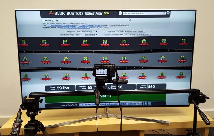

  1. Purchase a Camera Rail (Amazon) – We recommend a rail about 25% wider than the display you test, in order to permit camera acceleration/deceleration room.  A great general-purpose rail is the IMORDEN 40″ (100cm) camera slider rail utilizing ball bearings for less than $100 USD!  You need a very stable, firm, low-rattle rail.
    Thanks to the invention of being able to verify tracking accuracy just by analyzing embedded tracking-accuracy data (“sync track”), you can simply use manual hand-propelled camera rails. There are other inexpensive methods that were also found to work:
    – It is possible to try hand-panning the camera for during quick tests, but it is much more difficult to get barely acceptable tracking accuracy, after many passes.
    – A home-made wheeled dolly can work with sufficient accuracy (Suggestion: low friction roller blade wheels, on a mini dolly sitting on a table, along a low-friction guide track).
    – Camera on a low-friction block, sliding on a low-friction surface (e.g. teflon or lubricated surface) along a low-friction guide. Tests were done on a method similiar to this, and it occasionally achieved a good tracking accuracy of <~1 pixel during 960 pixels/sec on small monitors over a 1/30sec timescale, when doing 20 passes.
    – Using the automatic burst shooting mode of your camera, can also help. It is very easy to visually identify which photos has good tracking accuracy.
    – For lower-quality but quick results, even hand-pursuits using handheld iPhone/Video (rail-less operation) can produce acceptable results. Use manual focus/exposure/white balance. Use a good frame stepping video player on the result, and then save the best freeze-frame.
  2. Get a digital camera, preferably with controllable exposure speed. Controllable exposure is preferable, though you can use any other cheap point-and-shoot camera too, even an iPhone camera, as long as it can cover a few monitor refresh cycles (but not too many). Casio EX-FC200S and EX-ZR200 also do high-speed 480fps and 1000fps video
  3. Mount the camera on the camera rail (or other sideways sliding/rolling mechanism).
  4. Adjust the resistance of camera rail to allow the camera to slide sideways as low-resistance as possible, without camera rattle.  Use a small amount of silicone lubricant, if necessary for low-resistance sliding.
  5. Put the camera rail assembly in front of your monitor to test. Lower your monitor as low as it can go. Raise the camera rail assembly (e.g. wood blocks) to match the level of the center of your screen. Make the rail as parallel as possible to the screen’s surface (very important for accuracy!). Make sure the camera rail assembly does not slide around (e.g. use vises, use heavy weights, bolt down)
  6. Set the camera exposure to 4 times the length of the monitor refresh.  For 120Hz, use a 1/30sec camera exposure. You can also use even longer exposures, once you become familiar with interpreting the Sync Track (or writing software that processes the photographs).
  7. NOTE: Stacking multiple refreshes into one camera exposure, improves the WYSIWYG accuracy of pursuit camera photographs, since it more closely simulates the continual sampling (“integration”) the human eye does while seeing. Stacking multiple refreshes also filters out high-speed temporal effects of certain displays (e.g. plasma subfields, temporal dithering, etc.) and far more closely resembles the average perceived motion blur that the human eye sees. In addition, multiple-refresh stacking also eliminates visible errors caused by camera shutter timing being out of phase with refresh timing. You may use a longer exposure (e.g. 1/10sec) to capture more than 4 refreshes, but this makes it harder to verify the correctness of the Pursuit Camera Sync Track since it is currently optimized to 4 refreshes.
  8. Load the Ghosting test pattern with the Pursuit Camera Sync Track.  Maximize the browser window.
  9. Pre-position the camera to point at the leftmost edge of the computer monitor, with the lens pointed at an angle that is as square as possible to the screen surface.
  10. Slide the camera sideways, to the right, at the same speed as on-screen motion, while pressing the shutter button. Keep the camera moving consistently while taking a photo (or holding the shutter button down, for burst shooting mode).
  11. Repeat steps 8-9 until the Sync Track looks like a horizontal ladder.
