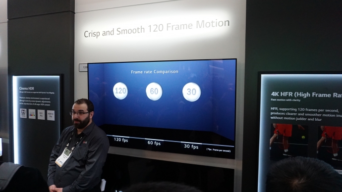

Visiting CES 2018, we had the opportunity to look at LG’s new OLEDs capable of playing back 120fps 4K HFR video, mentioned earlier this month.
While these OLEDs do not yet have direct 120Hz from external sources, they are capable of playing 4K 120fps HFR streams. I can confirm that these are genuine HFR videos, rather than interpolation — spinning helicoptor blade demo looked correctly 120fps.
My camera has a method of detecting BFI (Black Frame Insertion), and I was able to confirm that this particular TV did not have BFI enabled.
