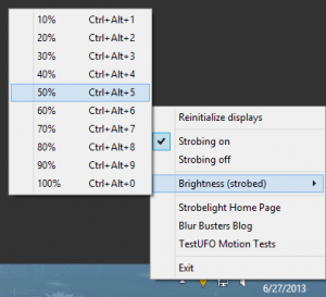

strobelight
LightBoost % via Strobelight
strobelight

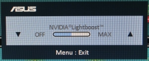

LightBoost % via ASUS On-Screen Menus
What is the LightBoost setting for?
LightBoost_settings
The LightBoost setting adjusts the length of the strobe flash of the LightBoost strobe backlight. Shorter backlight flashes per refresh, results in lower persistence, which leads to less display motion blur when your eyes are tracking moving objects.

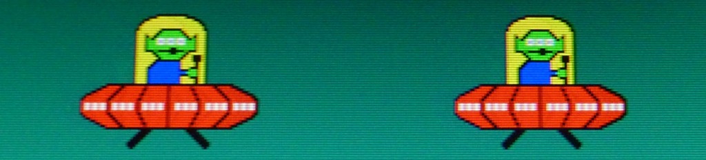

LightBoost = 50%: Backlight strobe flash of about 1.9 milliseconds per refresh.
This results in slightly less than ~2 pixels of motion blur during 960 pixels/sec motion.
The alien eyes are still blurred, but vertical edges are now slightly sharper.
CROPPED_LightBoost50

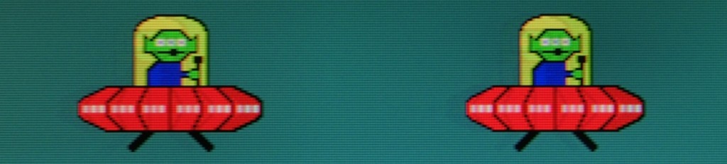

LightBoost = 10%: Backlight strobe flash of about 1.4 milliseconds per refresh.
This results in approximately ~1 pixel of motion blur during 960 pixels/sec motion.
The alien eyes are now crisp, and vertical edges are now crisp.
CROPPED_LightBoost10
